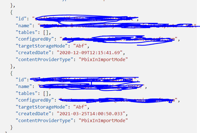

When the tables are blank, everything lower in the json hierachy to the table is absent- so for example the M-Code that loads the table.
I am currently working on a large database migration project where we need to repoint several  thousand Power BI reports from a legacy database to a cloud database. We were hoping to use the connection string in the M-Code to identify Power BI reports that need to be migrated. But after examining the json files from Scanner API ,  66%  our datasets don't have table data /metadata.
As a part of my investigation, I looked at how many datasets had no Table information i.e  "tables": [] appearing in the json file. The proportion of datasets with no tables appearing is decreasing relative to the dataset creation date (see below).  One hypothesis I had was this was linked to the release of the Enhanced Metadata engine and how mashup data is stored in a PBIX file.

3) We are getting valid json back, it is just that some datasets are missing Table information, when the dataset definitely has tables.  See two examples below- One dataset has table information, one doesn't. empty Table.JPGTable right.JPG
OK - more research. It would appear that this low level metadata relating to datasets is only generated/available  for datasets that are refreshed or republished. Will cross check the absence of Table & column  metadata /M-Code etc, against the presence of refreshes. https://docs.microsoft.com/en-us/power-bi/enterprise/service-admin-metadata-scanningTables.JPG
