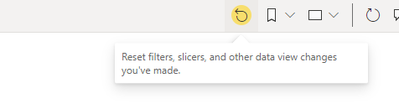

Just for people who also faced the same issue, I just tried to reset filters on PBI service and the multiple select is now on display.
Only strange thing was, that filter was never exactly a single select filter. So not sure why the cache remembered it as single select.

It works for me after clicking on the below, perhaps you can ask your users to try:

The "reset filters and slicers" option at the top suggested by another user seems to have worked in resolving it. Interestingly, my personal button set to reset slicers did not work.
