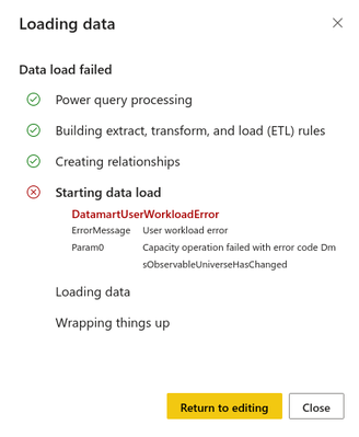

@v-yingjl I now have a second broken Datamarket. I have once again lost all my work. This time I got the error preceeding it. This time, I also havent made a mistake in the query. It was a conditional column.
Before that, after saving my transform, I had a " Error 500 lock timed out", which allowed me to go back to editing. Retrying again gives me that message.
This datamarket today is now in the same state: "
Unable to open the datamart because it is not connected to its dataset. Wait a few seconds, and then try again."
Trying to restart it, gives the following:
