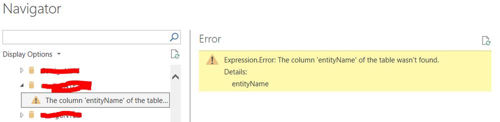

I have the same issue, starting yesterday (April 22nd)
The error I get is: "The powerquery job failed with error: Exception ExceptionType:MashupEvaluationException, ExceptionMessage:Expression.Error: The column 'entityName' of the table wasn't found."
I have no 'entityName' column in my table/dataflow.
I tried to create a new dataflow in power apps using the Power Platfrom Dataflow connector and I get the same error:

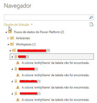

We are having the same problem, only in the Power Platform Dataflow connector.
This problem started on April 12 with the Power BI Desktop update, where we had previously requested support from Microsoft.
However, as of today, April 25, the problem is also present in the Power BI Service, as shown below:
2021-04-25 17_31_03-Power BI e mais 7 páginas - Perfil 1 — Microsoft​ Edge.png  2021-04-25 17_48_57-Navegador.png
Microsoft team, please test the updates first before launching to the public, these errors can yield a lot of financial loss to your customers.
