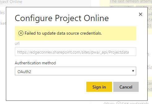

Same issue here with project Online data source , it is hang on loading the credentials. Not accepting valide O365 credentails.
Earlier it was working fine but this is happening from the latest updates, post December last week update.
Schedule Refresh is working now, it is accepting creadentials without any issues. Hope it is working for every one.
