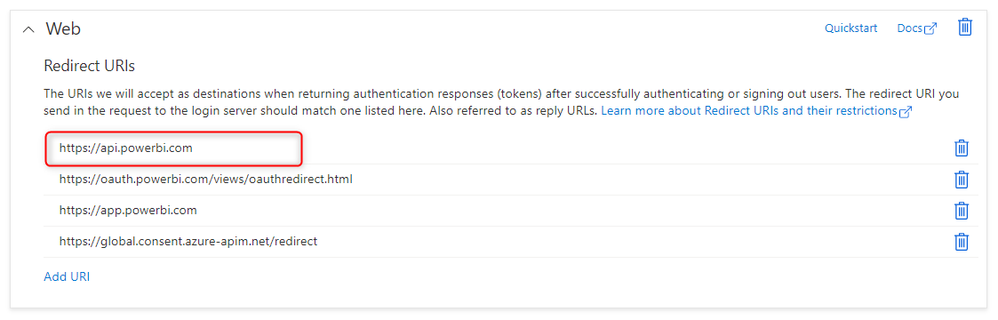

I'm struggling to see what my issue is when attempting to utilize the enhanced dataset refresh via the REST api and Power Automate. I'm getting a 403 error when trying to add optional parameters for Asynchronous refresh:
As per requirements, I have supplied and ensured that I have all of the criteria:
Scope:
Next, for authentication, it says all calls must be authenticated with a valid AAD, and I believe I have everything that's required:
Side Note: If I don't add the optional parameters my refresh kicks off just fine
Can anyone spot an issue with my settings / configurations?

Hi @tackytechtom!
Thanks for the response and amazing looking blob post! All my settings seems identical to yours and I don't see any abnormality from that but let me check the tenant level settings and see if anything is off.
