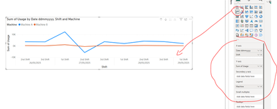

Hello everyone,
Can anyone help me with the below problem?

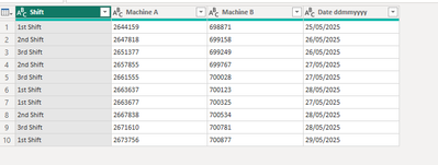

I have attached table named "Raw Data" which contains the Date, Shift, Machine A & Machine B columns. Machine A & Machine B columns has reading of perticular machine stroks that machine has done in entire shift which is always in increasing manner.
I want to calculate the difference between two reading of machine A as shown in the table named "Resultant Data". (similar, for the machine B also). then, want two plot a line chart indicating difference A & Difference B with respect to date & shift.

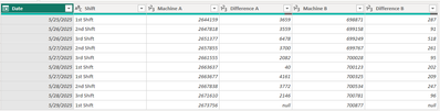

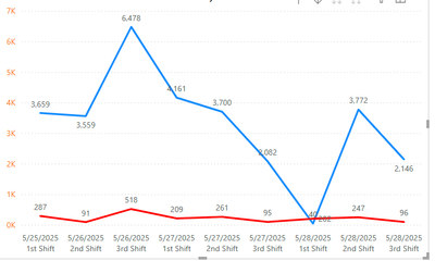

Resultant Data:
| Date | Shift | Machine A | Difference A | Machine B | Difference B |
| 5-25-2025 | 1st Shift | 2644159 | 3659 | 698871 | 287 |
| 5-26-2025 | 2nd Shift | 2647818 | 3559 | 699158 | 91 |
| 5-26-2025 | 3rd Shift | 2651377 | 6478 | 699249 | 518 |
| 5-27-2025 | 2nd Shift | 2657855 | 3700 | 699767 | 261 |
| 5-27-2025 | 3rd Shift | 2661555 | 2082 | 700028 | 95 |
| 5-28-2025 | 1st Shift | 2663637 | 40 | 700123 | 202 |
| 5-27-2025 | 1st Shift | 2663677 | 4161 | 700325 | 209 |
| 5-28-2025 | 2nd Shift | 2667838 | 3772 | 700534 | 247 |
| 5-28-2025 | 3rd Shift | 2671610 | 2146 | 700781 | 96 |
| 5-29-2025 | 1st Shift | 2673756 | 4431 | 700877 | -700877 |
Note A: In resultant column, I have calculated the Difference A & Difference B columns via formula. Please suggest measure & calculated column (both ways) to derived the difference.

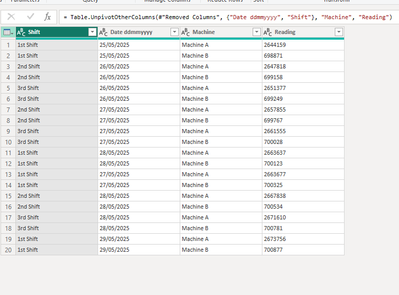

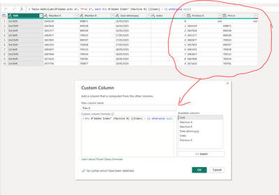

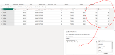

How it works ...

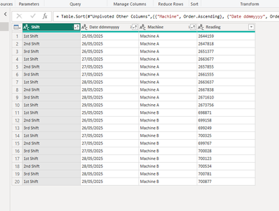

For the date correctly

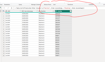

Select the Date and Shift columns, then Transform> Unpiciot>Unpivot other columns
Sort by Machine, Date and Shift

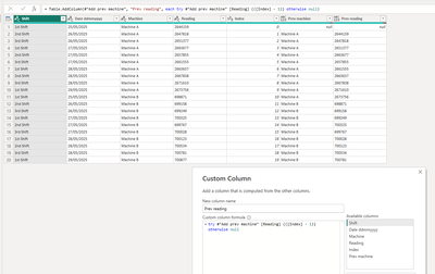

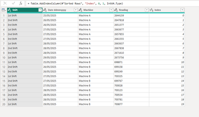

Add an index column from 0 incrementing by 1

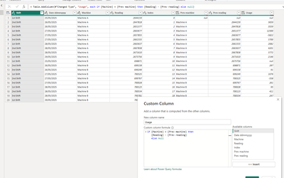

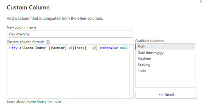

Get the machine and reading for the previous row
Change reading to numeric data types
and add a conditional column
Renove the unneeded columns and change the usage ro a numeric data type

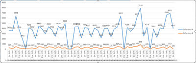

Draw your graph

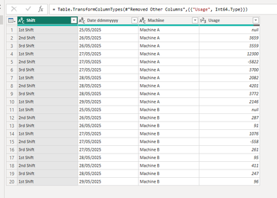

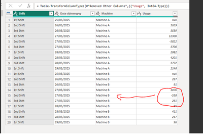

In the above example I assumed that shift #2 comes after shift #1, but this creates negative usage on the 27/05/2025
In this method I have sorted by machine and reading number
Click here to download from Onedrive
I dont know what sequence you require, but I trust I have taught you the method well enough now
and that you can change the sort sequence as you require

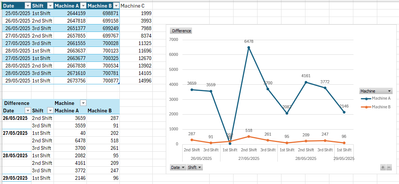

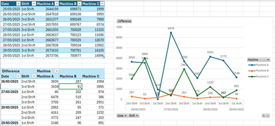

In the attached workbook we have:
You will also notice next to your source data, a column E for a Machine C. This data isn't included in the pivot and chart because it's not currently part of your source data.
However, dragging the grab-handle bottom right of your data so that column E does become part of the source data table, then refreshing the pivot table yields the following:
Note:
I noticed what appears to be an anomaly with your source data where the dates/shifts seem to be out of order:
The 1st shift on the 27th May seems to take place after the 1st Shift on the 28th May. Consequently, there's a step in my query which sorts on the stroks count which really shouldn't be there.

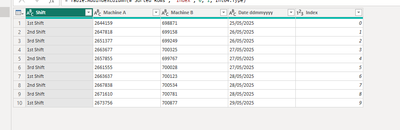

Hey @Nicks612 ,
To calculate the difference in readings (Machine A and Machine B) shift-wise in Power BI using DAX and Power Query, here's a detailed breakdown for both approaches.
You can sort the data and use the Index method to calculate the difference:
Sort the table:
Sort by Date (ascending), then Shift (custom order: 1st Shift, 2nd Shift, 3rd Shift).
Add Index Column:
Add an Index column starting from 0.
Duplicate the table:
Right-click the query and Duplicate.
Rename duplicated columns:
Rename Machine A to Prev Machine A, Machine B to Prev Machine B, and Index to Prev Index.
Merge Queries:
Merge the original table with the duplicated one using:
Index = Prev Index + 1 (join on: Index from original and Prev Index from duplicate).
Expand columns:
Expand Prev Machine A and Prev Machine B.
Add Difference columns:
Difference A = [Machine A] - [Prev Machine A] Difference B = [Machine B] - [Prev Machine B]

There are lots of ways to solve this problem but try this ...
Click here to download a solution from Onedrive
How it works ...
Change bakue data types to numeric
Change the date to a proper date.
Sort by date and shift.
Add Index colum
Use the index to get the previous meter reading for A.
Then use the index to get the previous meter reading for B.
Calculate the usage
Draw the graph
Please click thumbs up because I have tried to help.
Then click [accept solution] if it works.
Many thanks !
Here is M-Code that will calculate the Difference columns, and arrange it in the order you show.
Paste the code below into the Advanced Editor to see how it works, then adapt it to your actual data.
Source = Table.FromRows(Json.Document(Binary.Decompress(Binary.FromText("bdBBCgIxDAXQq0jXIzRJk5+ew+UwOxHduNC5P5bWkakd6CLQx+cn8xz0zOVF1jAFeq+ny/1xW8vMlhJpLpNld1BYpoptw/y87jGcvOJM6gOW1x4rCdAwp7xhHCcrXLVhGAbcJxtpxYgx8q+GHy9oYoKGiWVIHjC+WMr3f3Lf2eDiDaukAfedQUax4XLEDefjGhCoNeylz7J8AA==", BinaryEncoding.Base64), Compression.Deflate)), let _t = ((type nullable text) meta [Serialized.Text = true]) in type table [Date = _t, Shift = _t, #"Machine A" = _t, #"Machine B" = _t]),
#"Changed Type" = Table.TransformColumnTypes(Source,{
{"Date", type date}, {"Shift", type text}, {"Machine A", Int64.Type}, {"Machine B", Int64.Type}}),
#"Add Differences" =
[a=List.Skip(#"Changed Type"[Machine A]),
b=List.Skip(#"Changed Type"[Machine B]),
c=List.Zip({a,#"Changed Type"[Machine A]}),
d=List.Zip({b,#"Changed Type"[Machine B]}),
e=List.Transform(c, each _{0} - _{1}),
f=List.Transform(d, each _{0} - _{1}),
g=Table.FromColumns(
Table.ToColumns(#"Changed Type")
& {e,f},
type table[Date=date, Shift=text,Machine A=Int64.Type,Machine B=Int64.Type,
Difference A=Int64.Type, Difference B=Int64.Type])][g],
#"Reordered Columns" = Table.ReorderColumns(#"Add Differences",
{"Date", "Shift", "Machine A", "Difference A", "Machine B", "Difference B"})
Results from your data:
Just by formatting the Line Chart visual, you can get this:
I don't know how to rotate the x-axis labels on this visual except by making the visual more narrow. I merely used Data and Shift for the x-axis and selected to concatenate the labels.
