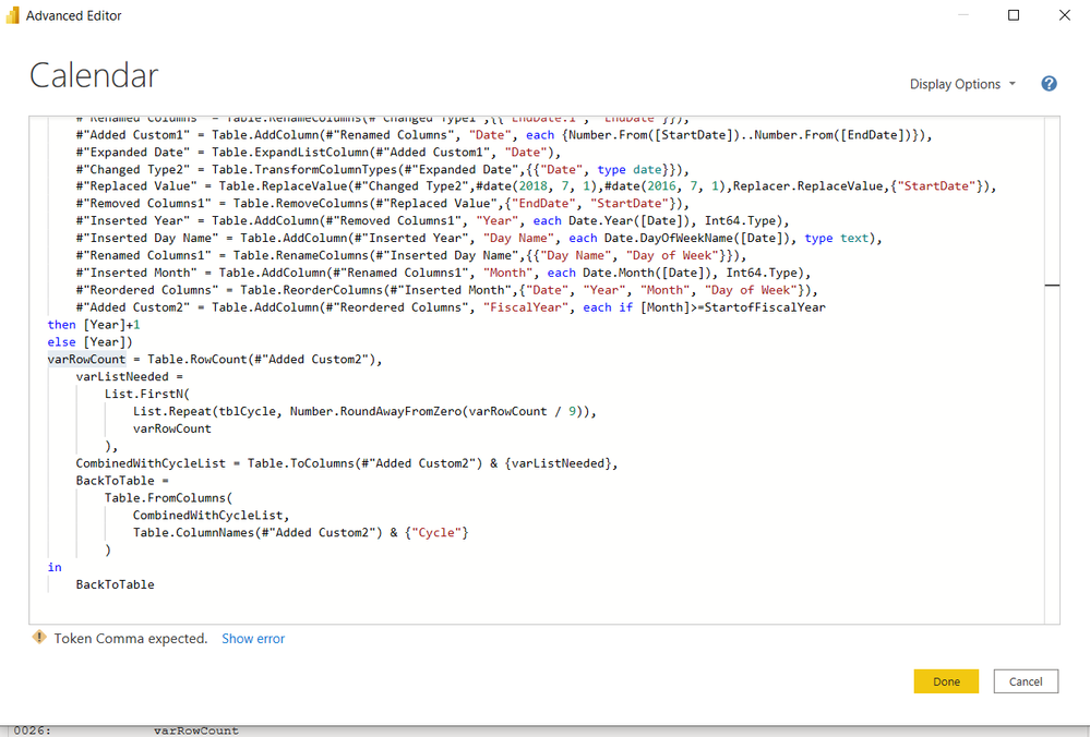

Thank you for your quick response. I apologize but i'm trying to add the final few steps in your coding to what I already have, and am getting stuck. I created a tblCycle as you described (I created it in PowerBI, not in excel). Here is what I already have for the Calendar table that I generated.
I'm looking to add the "Cycle" column to the Right of "Fiscal Year" in my table.
