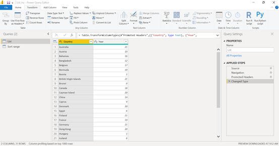

I have 2 column country name and number of year for each row. Next, I change the number of year to Text to group then into <5, 6-10, 11-15, 16-20 and 21-25.
I put the groupping into column of a matrix table but I am unable to sort the column in ascending order.
The sort order is showing this
I have tried to create a new table like this and wanted to append it into the original table and use the Sort by Column in Data View. However, the grouped range does not shown in Power Query for me to do the append operation.
Thus, what should I try to sort the group column in ascending order?
Here is the sample data that I have tried.
https://drive.google.com/file/d/1knjW26Qo0WbqoL8O9e7vIVmwFs8wtuuK/view?usp=sharing

I am still stuck with the Merge part. I have created a new table called Sort Range. However, there are some issue as I am unable to click on OK button to proceed.
The issue is due to different data type. In Data View, both Year and Range are in Text data type.
However, the Year in Power Query become Whole number.
When merging it needs to be on unique Identifiers which I only realised you don't have common unique ID's when I saw the snippet of the 2 tables you have.
However hopefully my answer before (involving creating a custom column) will help you achieve what you need.
