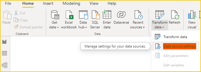

You may consider replacing the data source and republishing it here.
