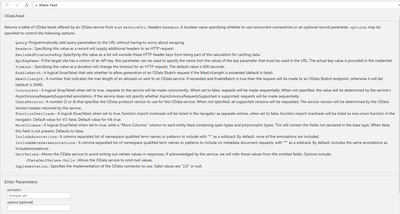

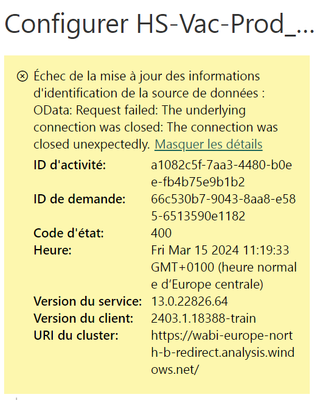

Power BI Service OData Connection Issue with SAML2 Authentication
Hello Power BI Community, I'm experiencing an issue with an OData connection to SAP in Power BI Service that I'm hoping someone could help me with. In Power BI Desktop, I've configured my connectio...

Hi coco6l ,
I think the reason why this parameter is ignored by the service has to do with the type of parameter you create when you create the parameter on the desktop, because according to the limitations described in the official documentation, "any" or "binary" type parameters are valid in Power BI Desktop, but we don't support them in the service at the moment!
Edit parameter settings in the Power BI service - Power BI | Microsoft Learn
You can try to change the parameter type, then re-upload it to the service and see if you can configure the credentials.
