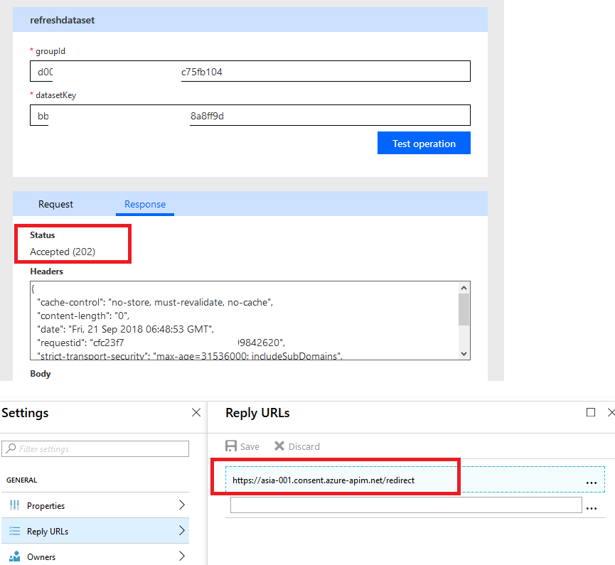

Hi @Anonymous,
According to my test, we only can keep one reply URL. Please change it and try again.

Hi Dale,
Thanks for the reply.
I see that it works for you , but for me after removing the other irrelevant Reply URLs I'm still getting 401 error.
 Operation failed (401), see response below

I have only the below URL as Reply URL for my app in Azure,
https://msmanaged-na.consent.azure-apim.net/redirect
