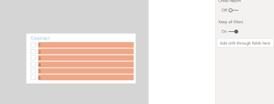

Created Power BI report and want to add white background only for filter section,
For that create image of background and set as page background,
Check here, White section for background and remaining as it is.
After uploading report on server image displayed in report, but after publishing file on web with Embedded then image disappeared from background.

Hi @Anonymous
This is another the sample file created with Background, Which i published on my platform then background image not displayed. I got that image in page load (in gzip) but didn't displayed in UI.
You can get the file from:
https://drive.google.com/file/d/1bKD37gVMOd_azQs2nqnp5Jae5IDOyL_d/view?usp=sharing
After publishing on plat form it looks like this:
And in power BI server Background image displayed:
And yes, if this issue from web hosting then at top US map with flag image also not uploaded.
Thanks.

Yes, I tried more than twice for the same but not getting Bg_image after embedded publish, It dispalyed in power BI server,
I'm using version 2.88.1682.0 64-bit (December 2020)
Issue remaining the same.
Yes I do that more than 5 times with different image extentions (.jpg, .png., ...),
Here please check section behing VIEWS, this is the screenshot from BI server publish.
Now when published it on web portal, background goes disapper.
what to do?
not getting any solution for it.
