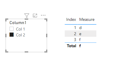

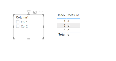

  • Hi  demian-cr ,
    I made a simple table as below:
    First create an index column in query editor;
    Then suppose col1 is the defaulting showing column,create a measure as below:
    Measure =
    IF(NOT(ISFILTERED('Table (2)'[Column1])),MAX('Table'[Col 1]),SWITCH(SELECTEDVALUE('Table (2)'[Column1]),
    "Col 1",MAX('Table'[Col 1]),"Col 2",MAX('Table'[Col 2])))
    And you will see:
    For the related .pbix file,pls see attached.
    Kelly

      • v-kelly-msft's avatar
        v-kelly-msft
        Hi  demian-cr ,
        Measure =
        And you will see:
        Kelly
