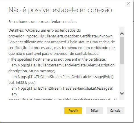

Hi!
I tried this solution step by step, but it did not work. I received this error message in response:

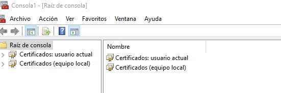

In order for this to work does the host name have to end in amazon.com or amazonaws.com?  The host name given to me from my client looks like this:
prod-dbpgsql-aaxxx.rds.us-east-1a.aws.systems.compnamedata.tools
I'm having the issue where it throws the error "The specified hostname was not present in the certificate" even though I have installed the certificate:
screenshot from MMC
thanks in advance for any help!

@datavigilante I'm not too sure.  I don't have acess to that machine to check now either.  Sorry!
@edwardrmiles, no problem.
I just got mine to work by using nslookup to see what the DNS record mapped to and then connected Power BI to the fully qualified db location.  And yes, it does end with amazonaws.com... 🙂
