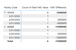

    You can create the following DAX measure to calculate the NAV difference from the previous month for each Facility Code:
    NAV Difference =
    VAR CurrentNAVDate = MAX('NAV_Data'[NAV Date])
    VAR CurrentFacility = MAX('NAV_Data'[Facility Code])
    VAR CurrentNAV =
        CALCULATE(
            SUM('NAV_Data'[Total NAV Value]),
            'NAV_Data'[Facility Code] = CurrentFacility,
            'NAV_Data'[NAV Date] = CurrentNAVDate
    VAR PrevNAVDate =
        CALCULATE(
            MAX('NAV_Data'[NAV Date]),
            FILTER(
                ALL('NAV_Data'),
                'NAV_Data'[Facility Code] = CurrentFacility &&
                'NAV_Data'[NAV Date] < CurrentNAVDate
    VAR PrevNAV =
        CALCULATE(
            'NAV_Data'[NAV Date] = PrevNAVDate
        IF(
            ISBLANK(PrevNAV),
            BLANK(),
            CurrentNAV - PrevNAV
    I tested it with my sample data, and it worked fine. Please find the attached screenshot and pbix for your reference.
