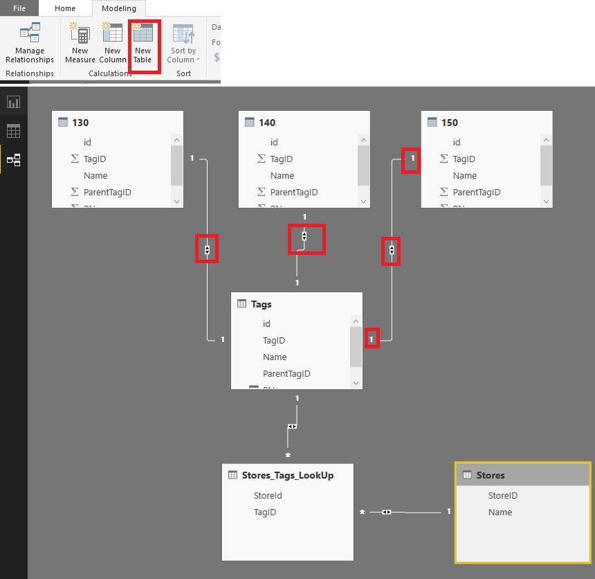

Hi Taher,
First, I would recommend a custom slicer.
Add a calculated column first in the table "tags".
PName =
IF (
[ParentTagID] = 130,
"Student",
IF ( [ParentTagID] = 140, "Worker", IF ( [ParentTagID] = 150, "Boss", "Null" ) )
Second, due to the measure can be put in a slicer, we have to filter these data to a new table.
130 = FILTER ( 'Tags', 'Tags'[ParentTagID] = 130 )
140 = FILTER ( 'Tags', 'Tags'[ParentTagID] = 140 )
150 = FILTER ( 'Tags', 'Tags'[ParentTagID] = 150 )
Best Regards!
Dale
hello @v-jiascu-msft,
we still have the same Problem.
when I for Example filter according to the worker 'Mark', it filters all the Bosses and the Students! But 'Mark' must filter just the ones who ist not in a pair with him in the original table ( Mark has John as a Boss and Andre as a student) these but disappeared too.
It is really difficult, I'v just tried and tried but it would not work.
Best,
Taher
