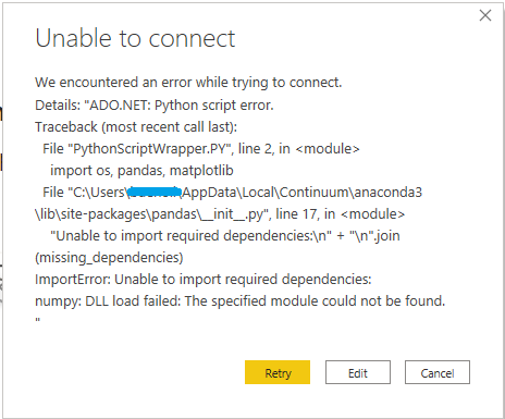

I'm trying to run the example below from Power Bi, however I'm getting the following error:
import pandas as pd
data = [['Alex',10],['Bob',12],['Clarke',13]]
df = pd.DataFrame(data,columns=['Name','Age'],dtype=float)
print (df)
Can anyone help please? I have the python scripting enabled in Power BI and packages installed
thanks!
@LauraBueno , Reinstall numpy. make sure you use PIP install

@amitchandak Thanks a lot! that worked! 🙂
