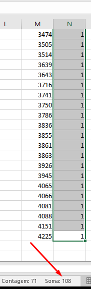

I used @Anonymous's solution and it mostly worked, but the 'total' row is wrong, and that really pains me because i need to create a pie chart from the data. However it does calculate the correct value per column:
108 should be the correct value here, not 393 (the excel data is exported from the power BI table). First column here is just an ID btw.
I read about row context, filter context and context transitions and i confess i'm a bit lost on the details, but i roughly understand row context as 'the row my operations see', and filter context as 'set of visible data for certain operations'. Supposedly for my problem i need to use the transition to apply a filter context to my count, but calculate (or the measure itself) should be doing that already. I don't understand what i'm supposed to change in my code.
With my limited knowledge of contexts, i didn't really understand what was @ryan_mayu's code supposed to do, particularly the 'earlier' part. Ryan's code however does not give me the correct count, instead giving me much higher numbers, which makes me think it's summing values on the whole column, not on a per-row basis.
