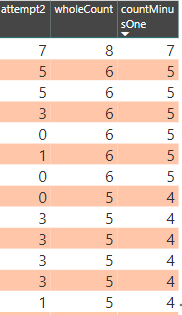

)However, this seems to cause the subtraction to be applied to every iteration of the count, causing the count to become zero for the 24->5 transitions, and some values seem a bit "weird". I attempted to create measures to count the amounts independently of the row context, and that works for displaying the subtracted value in a table, but as soon as i reference the measure in the calculated column, the result is the same. The table shows the "weirdness" i mentioned earlier, i suspect it is subtracting one for each counted element except the filtered ones:
attempt2 =
if( 'merge journals details'[old_status]="24"
; //True
[countMinusOne]
; //False
[wholeCount]
The goal here (as the code seems to imply) would be having the 'attempt2' calculated column have the same values as the 'countMinusOne' column when the 'IF' statement is true, and the same values as the 'wholeCount' column when the statement is false, but instead, all true statements are returning zero, and many false statements are returning different numbers from both columns.
