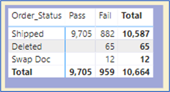

My DESIRED MATRIX is as follows with both subtotals and totals reflecting 10,664 Purchase Orders:

Thank you so much Allison... your code gave me precisely what I was seeking!!
As of today, you are officially my hero.  🙂
