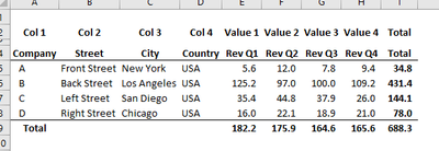

Hi, I am having troubles showing multiple Columns together with mulitple Values. This is a very easy thing to do using pivote tables, but I couldn't figure out how to do this in Power BI with neither a Table nor a Matrix. For example, the closest thing to what I want to create, would be the Matrix, but it only allows me to show 1 column with the 4 values, instead of 4 columns with 4 values. See below the ideal version. How do I show Multiple Columns together with Mulitple Values?

Thanks for your reply. Below are both, the CURRENT version and the IDEAL version. No matter how many columns I add, it will only show the first one.
CURRENT:
IDEAL:
I can see in visualizations that the additional columns are there, but they won't show.
