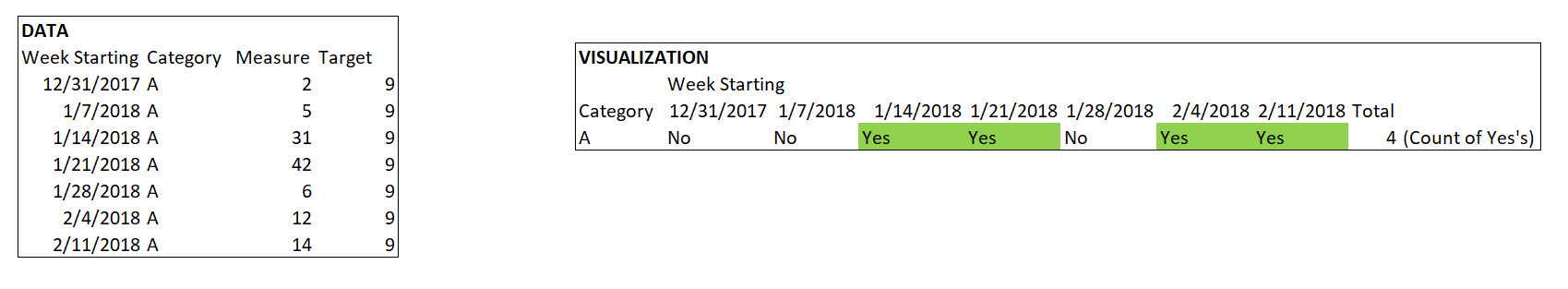

I'm new to PowerBI and I'm trying to create the visualization below and am having trouble because of a few areas:
1. I am getting an error with dates because there are gaps in the dates I'm using due to them being weekly data.
2. I am having trouble re-formatting dates because PowerBI is putting in a long-winded full date ("Monday, January 1, 2018" instead of "01/01/2018")
3. I have not figured out how to do a countif using strings.
Any help or advice would be greatly appreciated.
Thanks!
  • Hi  Anonymous,
    I'm assuming that you want to return Yes when measure is greater than target.
    Use the following measure to add to your matrix:
    YES / NO =
    IF (
        HASONEFILTER ( Data[Week Starting] );
        IF ( SUM ( Data[Measure] ) < SUM ( Data[Target] ); "No"; "Yes" );
        COUNTROWS (
            FILTER (
                SUMMARIZE (
                    Data;
                    Data[Week Starting];
                    "YES/NO"; SUM ( Data[Measure] ) - SUM ( Data[Target] )
                [YES/NO] > 0
    MFelix

    7 years ago
    Hi Anonymous,
    Select the date column then select the modeling on the bar and format the date as you need.
    MFelix

      Thanks Felix!! This is great! Any advice on how to adjust the format of the dates as columns?
      Cheers,
      Julian
      • MFelix's avatar
        MFelix
        Hi Anonymous,
        MFelix
