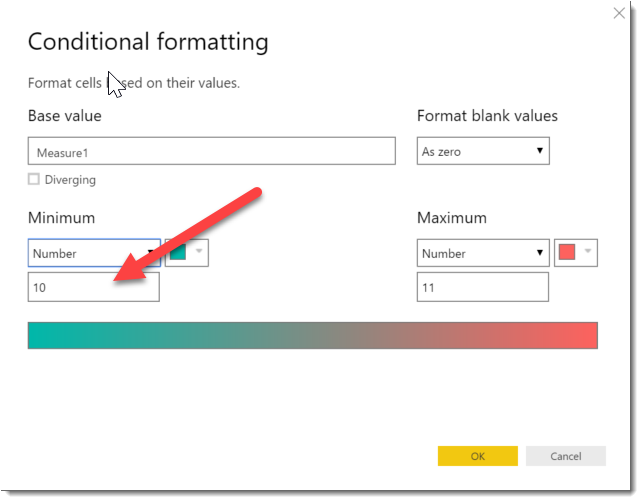

On the conditional formatting options for your measure on the matrix, Specify the Minimum and Maximum as Numbers and try these values.
Let us know how you get on.
