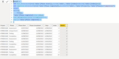

Hi SAW , try this:
- Insert a Index column in Power Query
- Create a calculate column with this formule:
Result = VAR Star_d=CALCULATE(MAX('Table'[Phase Start]),FILTER('Table','Table'[Index]=EARLIER('Table'[Index])+1)) VAR Completed_d=CALCULATE(MAX('Table'[Phase Completed]),ALLEXCEPT('Table','Table'[Project]),'Table'[Phase]<>"Completion") return SWITCH( TRUE(), 'Table'[Phase Completed]-Star_d>0,0, Star_d>Completed_d,Star_d-Completed_d-1, Star_d-'Table'[Phase Completed]-1 )With the small sample you have sent, it works:
Best regards
Hi SAW
I'm a little confused about the calculation logic of the last project.
It seems that total are 13 days. 7 days from 7/12 to 7/20 and 6 days from 8/12 to 8/19.
Did I understand your demands correctly ?
Best regards,
Yadong Fang
v-yadongf-msft For the last project, the Testing phase is concurrent with the Assessment phase and therefore doesn't contribute to idle time. The second group of days resulting in a day of idle time comes between the end of the Assessment phase and the beginning of the Completion phase (see highlighted areas below):
