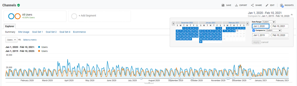

I am looking to recreate the image below in Power BI Desktop.
There is definitely DAX time intelligence involved here. I believe I will also need to create a Comparison Date table as well.
Any help would be much appreciated.
Thank you!
