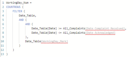

When creating a new column using the below code, this method equates to an #ERROR (see attached screenshot)
WorkingDay_Num = COUNTROWS ( FILTER ( DimDate, AND ( AND ( DimDate[Date] >= NetWorkDays[Start date], DimDate[Date] <= NetWorkDays[End date] ), DimDate[WorkingDay_Mark] ) ) )

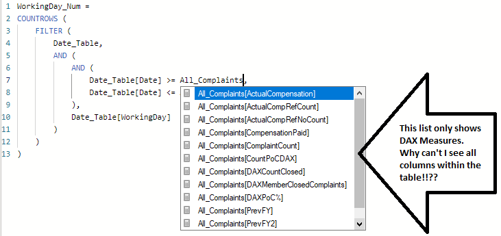

Why doesn't it like these columns? Just because they are not DAX!!??
Frustrating that forum user examples vary from what can actually be done in Power BI
Were your columns on the 'NetworkDays' table named [Start Date] & [End Date] DAX/Measures?
Is there any reason why I can only choose measures?
