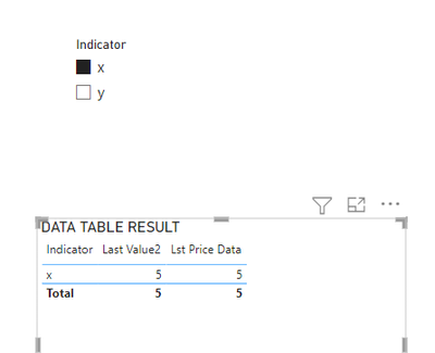

Hi:
If you want a more simple measure using LASTNONBLANK, you can use:
Hi:
I did this by first putting a calc column in the table (I called table "Data")
Then I followed with a measure. * I have a Date Table Attached.
Calc Col:
I hope this helps!

Try this..
Measure =
var maxdate = CALCULATE(MAX('Table'[Date]),'Table'[Indicator] = "x", NOT ISBLANK('Table'[Value2]))
return CALCULATE(MAX('Table'[Value2]),'Table'[Date]=maxdate,'Table'[Indicator] = "x")
