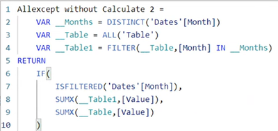

Screens from @Greg_Deckler ALLEXCEPT without CALCULATE video:
Before:
After:
For me this topic looks corelated with SQLBI experts materials about Variables in DAX.
Basicaly, you are talking the same things by different words: how to write code that works like estimated.
Just "NO CALCULATE" title is a bit more "flashy".
Last example by  @marcorusso   Debugging DAX measures in Power BI (first 12 minutes):
Before: Beautiful&Compact, but not working as estimated:
After: Verbose, but understandable&debuggable and working as estimated:
