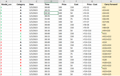

Calculated column using DAX
Hi Guys,
I need urgent help with the DAX function to calculate column H of the below dummy data table in Power BI.
Important to consider :
The Formula should consider Column A, B, C, and D as unique for each row, since as you can see that column H is calculated based on value of a column G in the current row + value of column H in the earlier row (within same model_run, category, date, but earlier time stamp).
Appreciate your help!

Sorry mate, if I misrepresented the Date column by keeping it the same date for all rows. But in reality, I have dates from 1/1/23 to 31/12/26, for each Category with Timestamp of 24 hour for each date.

Hi, thanks again, I applied it but the result is wrong, In below screenshot, the Carry forward column has the correct result (manually done in excel) and the calculated column is using ur DAX.

Hi Dangar,
Thank you for your help earlier. I have realised some changes in my original dataset, herewith am attaching a screenshot of dummy data which is the actual representation of my real data. Can you pls help me modify the DAX function accordingly? I have manually calculated in Excel for your clear understanding and mentioned the condition as well.

Hi, @gandharv
please paste data here or provide data file
Model_RunAreaDateTimePriceCostPrice - Cost (Value)Carry forward (Value)Carry forward (Formula)
1A1/1/202300:00100150-500=IF(G2 < 0, 0, G2)Condition for the column: Carry Forward shouldn't be less than 0
