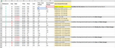

Hi Guys,
Please, I need urgent help with the DAX function to calculate column H in the below dummy data table. I have mentioned the manual calculation in the Excel table for a better understanding of the ask!
Important to consider :
The Formula should consider Column A, B, C, and D as unique for each row, since as you can see that column H is calculated based on value of a column G in the current row + value of column H in the earlier row (within same model_run, area, date, but earlier time stamp).

Hi, @gandharv
try below
but cross check it before move  ahead
Column =
var a =
    FILTER('Table (2)',
           'Table (2)'[Model_Run]=EARLIER('Table (2)'[Model_Run]) &&
           'Table (2)'[Area] = EARLIER('Table (2)'[Area]) &&
           'Table (2)'[Date] = EARLIER('Table (2)'[Date]) &&
           'Table (2)'[Time]<= EARLIER('Table (2)'[Time])
var b = MINX('Table (2)','Table (2)'[Time])
var d = MINX(FILTER('Table (2)','Table (2)'[Time]=b),'Table (2)'[Price - Cost (Value)])
var c = SUMX(a,'Table (2)'[Price - Cost (Value)])-d
return
IF(c<0,0,c)

Hi, @gandharv
try below
Column =
var a =
    FILTER('Table (2)',
return
IF(c<0,0,c)
