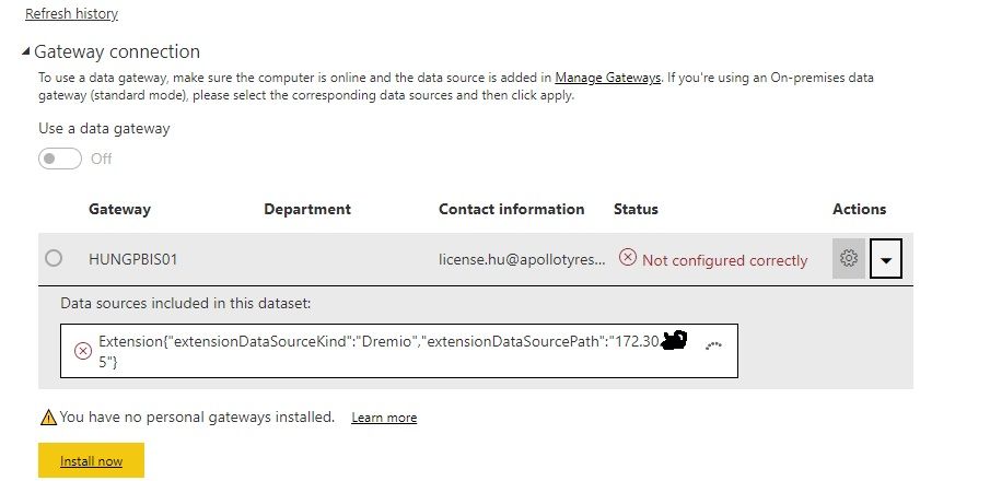

we have setup an SAP - Dremio - PBI connection that works well in Desktop environment. When we publish it is not working, other published reports are running fine in the Service mode. So the first error when opening the report is shown below:
the when we follow the link we get:
We manually added the gateway, we followed the option in the menu and get:
So basically we made connection, but still, the report is not working. We keep getting the message 'not configured correctly'. Please share your thoughts we are out of ideas.

How I corrected this was by changing the Advanced Query to directly call the table in the first step itself.. and now Direct Querying on Power BI service works !!!
Also, another point to note is that the data source name should be the same on Power BI Desktop & the On-premise gateway. It needs to be either "host" or "host:port" on both ends...

To anyone who encounters the same problem, besides the anonymous answer, you should also check the "Name" of the DataSource inside Power BI Desktop.
It should have ":port" in it like below
Somehow, when creating a Dremio Software connection, my Power BI just removes the port part in the name. In the Desktop, it works fine, but when published to the Web Service, it gets the same error as the author. I have to manually add the port part in the Advanced Editor in Power Query.
