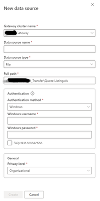

Here is the screenshot of where it give you the option to edit the full path, this is what you get when you click the 'Add to gateway' button in the Dataset settings.  The Full Path field is editable here:
Tutu_in_YYC
If i read this correctly, you set up your report datasource using Path1 (c:\myfolder\myfile.xls), but once you published this to the service, you are trying to connect Path2 (\\servername\fileshare\myfile.xls) to the dataset through the gateway. Is that right? If yes, my guess is Path1 is still the one that is being used in the M query, and you cant edit the Path1 to Path2 through Power BI service.
Can you provide a screenshot of where you have the option to change the full path?
