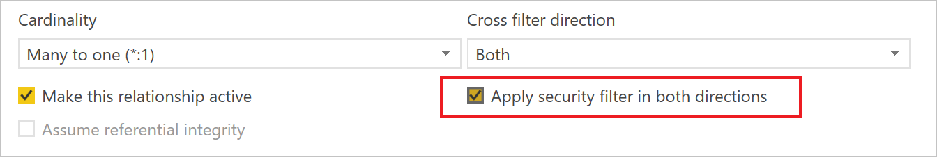

Both of which mentions that I need to use this setting in the relationships tab
Apply Security Filter
I am assuming that maybe my model is not working due to this, but when I tried to enable this option I hit the following error
[Table 'USER_SECURITY' is configured for row level security, introducing constraints on how security filters are specified. The setting for security filter behavior on relationship ' ' cannot be both]

If you had to look at the RLS pattern the issue is that you need to have it set up slightly differently.
I can confirm that yes the Viewer Role in an App Workspace will confirm that it will keep the RLS.
If you can test and read this blog post from Kasper where you can play with the model and get it working, which will give you a great understanding of how it all works: https://www.kasperonbi.com/power-bi-desktop-dynamic-security-cheat-sheet/

Another interseting point, I noticed is that with the sample from kaspersky, it looks like there is a "bridge" table, lack of a better word that helps to unify the users and the profiles together. Then I am able to use both directions, and apply row level security check box.
Im still a bit gray on how relationships work in Power BI, in terms of the direction (single or both direction) but I think Im getting a bit of a better handle on things now, thanks to your post

With regards to the cross-filter direction set to both, this allows for the security to flow between the tables, which then means that it will then correctly apply the security.
