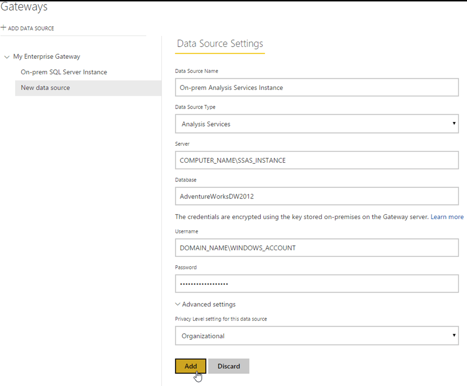

When you Added the data source in the Gateway on the Power BI Service, what did you set the privacy settings to under Advanced? It should also be set to None for each of the data sources
Power BI Blog
Hi @GilbertQ
You are amazing 🙂
On the Power BI Service website, I found one data source's privacy level is set to None and the others are Organizational.
After I changed the None one to Organizational (by deleting it and creating another Organizational one), the report refresh works again.

With regards to your questions, from my understanding the Privacy settings should be the same between the desktop and the service.
When you create a data source in the Gateway it appears that the privacy setting cannot be modified and needs to be re-created and have the new privacy setting applied in that way.
