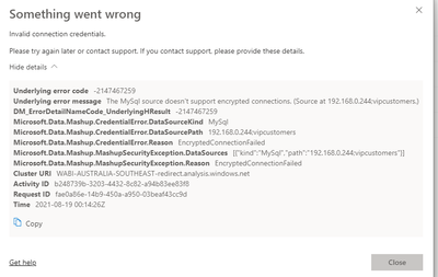

I have searched extensively online about this issue and nothing resolved it for me, hoping somoene can please guide me.
So, currently I have a powerbi file which is connected to a MySQL database on an onprem server.
I am able to access it with the power BI desktop with the credentials.
I downloaded the gateway and it shows connection successful only if I select skip test connection
If I uncheck the Skip Test connection and enter the credientials of the database which has full root rights, it gives me this error:
Please if someone could guide me on how to fix this I would immensely appreciate it!
Thanks!!!
  • Your gateway screenshot says "Not encrypted"  but the error message suggests a failed attempt at an encrypted connection. This doesn't add up.  Please clarify.
    ALSO NOTE:  MySQL support on the gateway is BROKEN after version 66.8 (or thereabouts) and Microsoft and MySQL shift the blame to each other.
    5 years ago
  • Hi,
    I got it to work! For anyone else experiencing this - I just had to reboot my MySQL server machiene. Seems like a reeboot is nessecary for the MySQL Connector to get configured.
    I'm using MySQL server 8.0.26 and it seems to be connected. I haven't tested the automatic data refresh yet.
    But it shows connected.
    Is there an alternative that I can use if MySQL connection is broken?
    Thanks!
