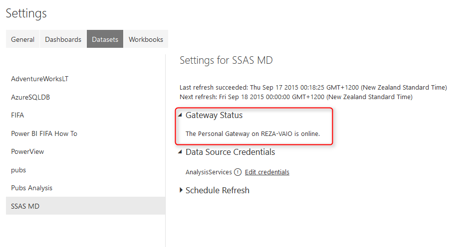

Ah, I see! That's what I meant, that it doesn't show up. 🙂
This is the dataset for my report that uses Import:
As you can see the Personal Gateway is shining bright like a diamond!
And here is the dataset for the report that uses DirectQuery:
In here the children only heard stories of the Personal Gateway' existence but have never seen it with their own eyes.
