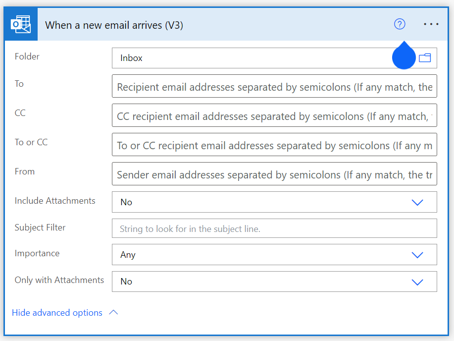

edhans
1. Create an Email trigger. This is an Office 365 email. Just set up the criteria.
2. Add an action to refresh a power bi dataset.
That is it. 2 steps.
MCSA: BI Reporting
