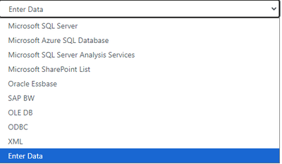

Hi
I am trying to create a data source to the Fabric DB in SSRS, but none of the options available work. However I was able to create an embedded connection using ODBC, but that doesnt work on the shared data souce
Would you be able to help on how do we create a successful data source for use in my SSRS environment?
