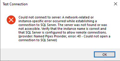

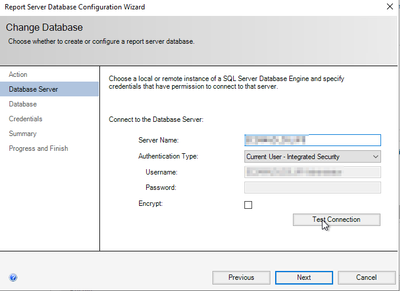

Seems like a really simple task, but unfortunately, this is my first time setting up PowerBI RS. I am having issues making the database connection in the configuration manager to our PostgreSQL database.
In the configuration manager in the "Database" section one can only go to "Change Database" button, after that a new prompt appears with "Create a new report server database", "Choose an existing report server database". Since I don't have any database present, I would go with the first one. --> Create a new report server database.
After that a page appears (see below), when I try to input the PostgreSQL server IP there I get an error.
I know I am doing something wrong, can somebody possibly provide some steps/actions to take to completly configure the database connection.

This is because the Report Server catalog database needs to be installed on a Microsoft SQL Server instance, you cannot put that database on Postgres.
@d_gosbell I get that part. I will install MSS instance to faciliate RS catalog. I initially thought, that maybe we can add postgre as a source in the RS as well, but that is not happening.
