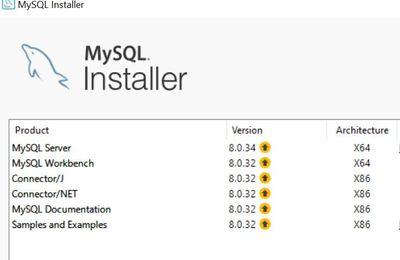

For anyone still having this issue, these versions work for me:
Server                            8.0.34
Workbench                    8.0.32
Connector/J                   8.0.32
Connector/NET              8.0.32
Documentation              8.0.32
Samples & Examples      8.0.32
Thanks for this detailed, updated info. Any idea if 8.0.35 (the latest version), like 8.0.34, still works, aka doesn't re-introduce the bug like 8.0.33 did?
