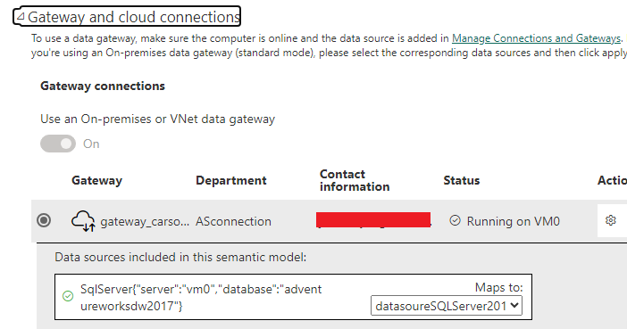

1. You need to create a parameter to store the data source information for your report.
I named it DatabaseName, and the parameter value is AdventureWorksDW2017.
2. You need to use this parameter in your power query Advanced Editor to replace the original data source name to get the data source (the use of the parameter can make the management of the data source more convenient, you only need to change the data source parameter to modify the data source, which is also the work of the implementation of this API)
After publish to Power BI Service, you can see that the original data source is AdventureWorksDW2017.
Meanwhile I successfully configured the gateway connection

After a successful run, refresh your browser and subsequently go back to the Power BI Service and view the report's data source, where the modification has successfully occurred (the parameter was modified successfully)
Since I had previously created separate gateway connections for both databases (2017 and 2022), the system automatically changed the database gateway connections when it detected a change in the data source (switching to database 2022)
The data source was successfully modified by using the API (by modifying the data source parameters)
