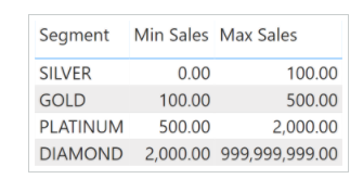

Is there a step by step for this somewhere?  I am looking to create a table like the one below.

Not certain what is your expected output. Did you want to create a group table with group A,B,C.. (when value is 0-100 group A etc.) or a group table with min value and max values to defien group or anything else?
In your posted picture, What dis the Min Sales and Max Sales represent? Did these fields all come from the data table?

CNENFRNL
@VPlorim , a little trick to use such a simplified segmenting table (named Segmt) to map a total volume,
Lvl =
VAR __total_volume = 500 //[Business Volumme Total]
VAR __lv =
    MINX ( FILTER ( SEGMT, SEGMT[Threshold] >= __total_volume ), SEGMT[Threshold] )
    CALCULATE ( MAX ( SEGMT[Segment] ), SEGMT[Threshold] = __lv )
