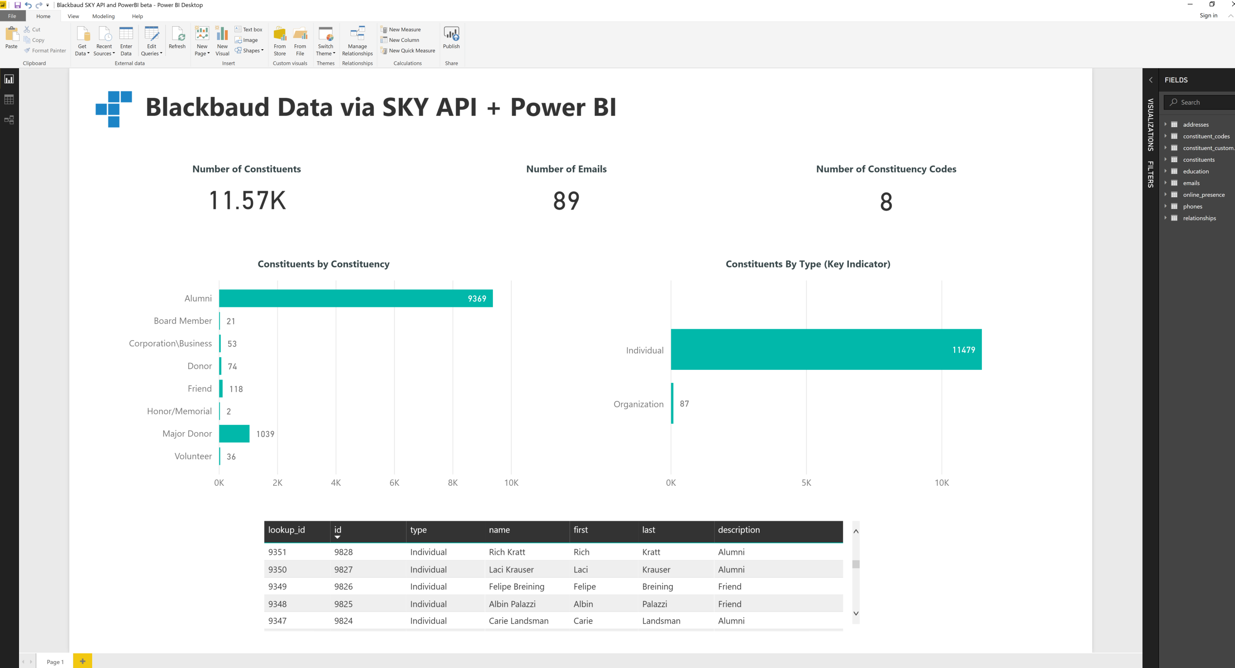

Custom App based on @Quicky GitHub:
Custom App Based on @Quicky GitHub
Working PBIX report connecting via custom connector from @Quicky modified .mez file:
PBIX report connecting via SKY API custom connector

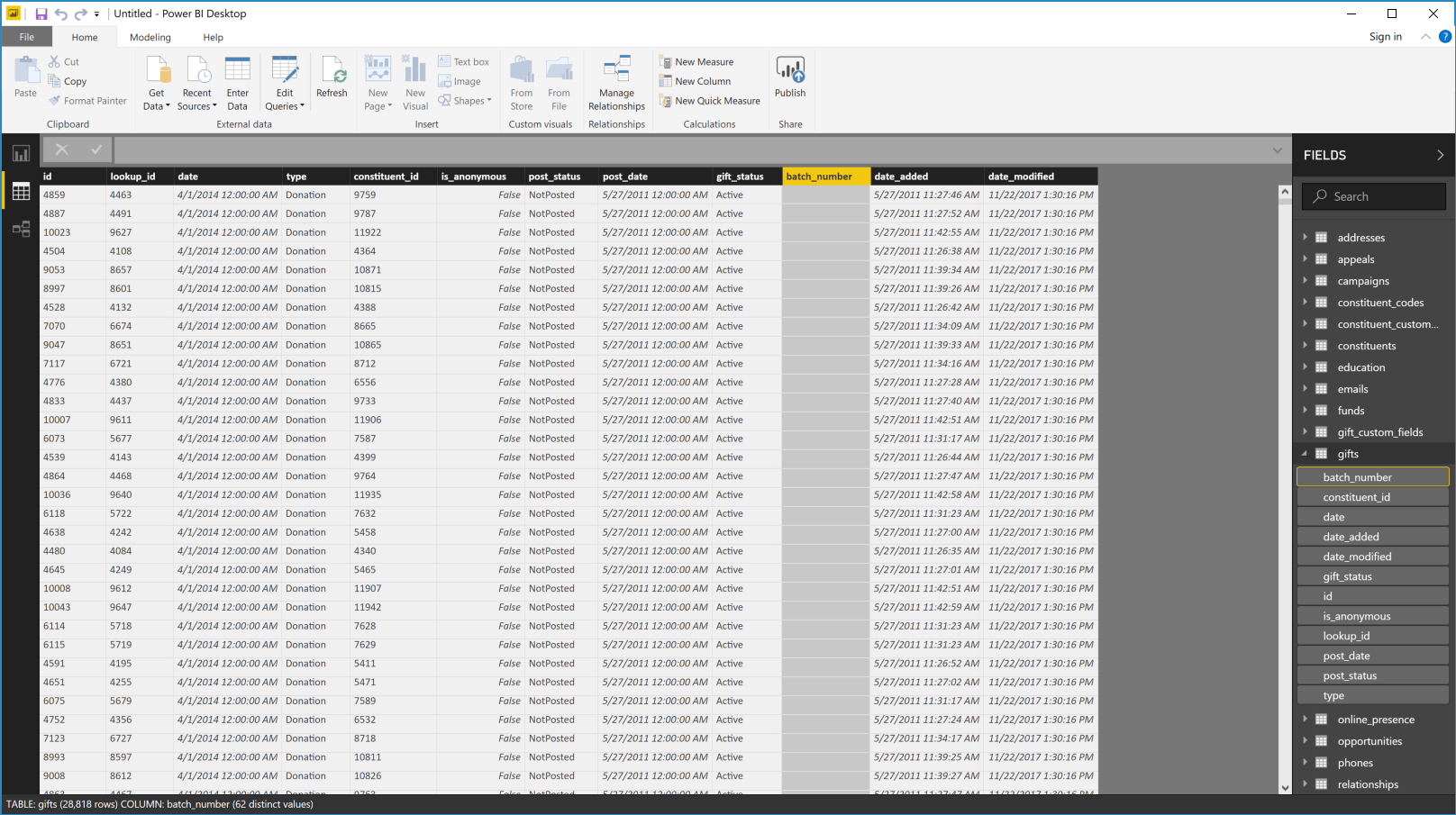

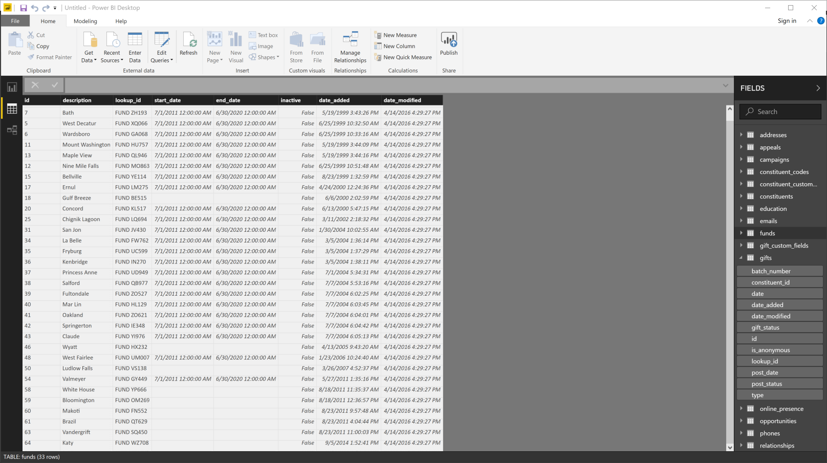

@Quicky this is great. I got the new mez working and can see the gift endpoints but, oddly, gift amount is no where to be found. Did I mess something up? I can see funds, gift dates, dates added, post date, but no gift amount anywhere.
Screenshots here:
Here are the values from the gift table that I'm seeing:
headers                               values
id                                         4859
lookup_id                             4463
date                                      4/1/2014 0:00
type                                      Donation
constituent_id                      9759
is_anonymous                      FALSE
post_status                           NotPosted
post_date                              5/27/2011 0:00
gift_status                             Active
batch_number
date_added                           5/27/2011 11:27
date_modified                       11/22/2017 13:30
@GGettyNo worries - the connector doesn't really do antything with regards to building a data model for you as yet, beyond pulling back all the data and setting the correct data types. The gift amounts are there, but because they are records themselves, you would need to tell the data model how you want them to be handled. In the case of the gift amounts, you would just need to expand the record. To do this, click Edit Queries, and you'll see all the data pulled back. You can then click the expand button in the corner of a column's header to surface the data.
