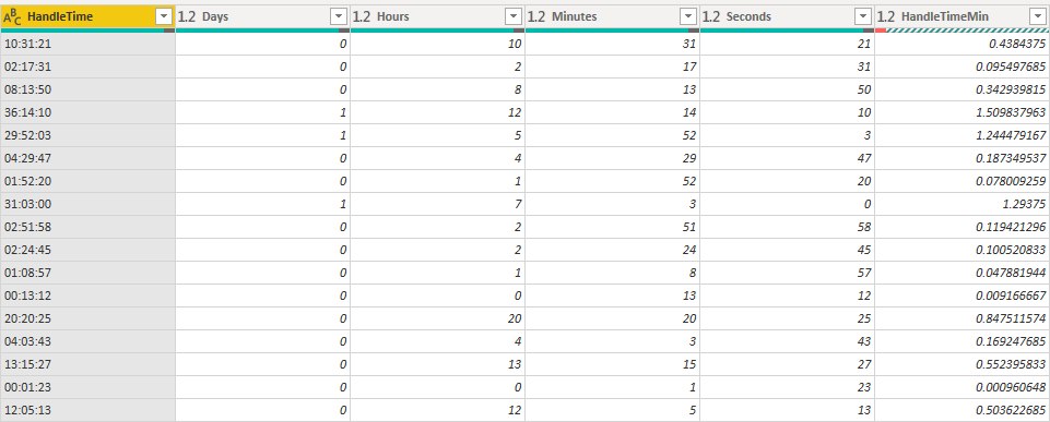

This is what the step looks like in the Advanced Editor for the query.
#"Added Custom1" = Table.AddColumn(#"Added Custom", "Custom", each #"fnTimeToMinutes (2)"(#"Added Custom","HandleTime"))
 I'm still seeing the issue from above though where the actual added column displays "Table" for each entry. I can drill down and get the right result (below), and I'm fine doing that drill down for each step if need be.
I didn't realize you were putting this inside a custom function that was being invoked from within an add column step.  Please change your step script to this:
#"Added Custom1" = #"fnTimeToMinutes (2)"(#"Added Custom","HandleTime")
Aha! Thank you! I think I understand the difference between what I had down vs what you shared right there.
I appreciate your patience here, especially because I wasn't quite giving you all the information needed :). I'll go ahead and mark your original comment as solved, as it answered the original question well.
