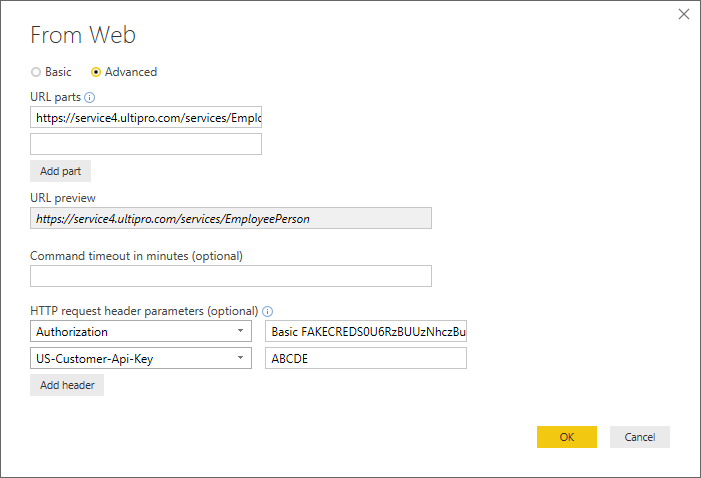

I'm trying to pull data from REST API. At the moment I'm facing some difficulties tyring to authenticate.
All I have is:
Link:
https://service4.ultipro.com/services/EmployeePerson
Authorization Headers:
"Authorization: Basic c29tZXVzZXI6c29tZXBhc3dvcmQ="
"US-Customer-Api-Key: ABCDE"
I get this Error when I click OK:
Details: "The 'Authorization' header is only supported when connecting anonymously. These headers can be used with all authentication types: Accept, Accept-Charset, Accept-Encoding, Accept-Language, Cache-Control, If-Modified-Since, Prefer, Referer"
Hi @surfersamu,
I have tested in Power BI desktop using the connection information you provided, there is no error throws out. After you fill the connection information like the image you provided and click OK button, please use Anonymous authentication, as you already provide the authorization key.

Hi guys,
I am tyring to get data from UtliPro REST API. The problem that I'm facing is that I don't know to how to authenticate with http headers.
This is what I have:
Link
HTTP Headers
Authorization:Basic FAKECREDSFUlZJQ0U6RzBUUzNhczBuMjAxNyE=
US-Customer-Api-Key:ABCDE
When I try this on the Get Data from Web dialog I get:

Hi @surfersamu,
You can download the attached pbix file to have a look. By the way, here are some samples of calling API to get data in Power BI:
