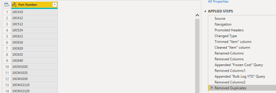

Diana2022
All:
It's even weirder.   I decided to append the three datasets that contain the Item/Part Numbers into a table called "Part Numbers".  And then delete duplicates.   And the result is only one "10C410", etc.   But when loaded and visualized...doubled up again.
In Manage Relationships each of the three datasets has an active relationship to the Parts Number table and no relationship to one another.

Hi- thank you for helping me!   Each Part Number in MADD_YTD table has two more characters than expected...even after TRIM and CLEAN.  This is true for every Part number examined regardless of its visual length.
