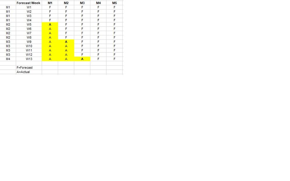

Data ModelData ModelData table - reportData table - report
I have the data model above with 2 fact tables.  One for Forecast and one for actuals.  They are at different granularities.  Forecasts are for the month - but done every week.  Actuals are added for the month when the month is complete.  I want a data table report as shown above actuals to replace forecast once they are available.  I am not xcertain if I need a different data-model or I need to de-normalize to a single fact table or DAX measures or DAX calculated columns.

This is a DAX problem, not power query. Your data model is fine. Break the problem into pieces and solve one problem at a time.
1. Write a measure that returns actual
2. Write a measure that returns forecast
3. Write a measure (probably using IF ) to show one or the other depending on the rules you describe.

@MattAllington  Matt, thanks for your reply - I am a DAX beginner, and I have tried numerous approaches - I continue to struggle.  Can you propose the structure of the DAX measure?  Nothing I do seems to work.  Maybe I can send a data sample file?  Any help is appreciated!
I can help you learn.  My view is you wont learn if I do it for you.  How about you post a sample workbook with what you have done.  I can then guide you from there.

I am using Excel/Power Query.
I simply add the ForecastUnitsForward measure to the SalesUnits measure for the integrated measure.
ForecastUnits Forward=
SUMX(
 'CDC Data',
 IF(RELATED('Table_Period'[Month])>='CDC Data'[Forecast Month],
 [Forecast Units],
 [Sales Units])
I have a row total problem.  Any guidance is appreciated.
