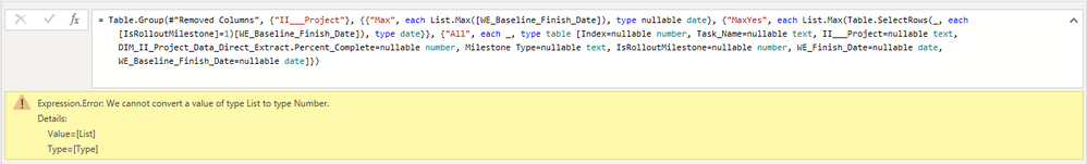

Thanks Pat. Unfortunately I am seeing the an error related to the query not being able to convert type List to type Number. I cannot quite identify what I should address to resolve in order to get the List column to appear.
If I excluded the ALL function, this does work but obviously this is not ideal.
= Table.Group(#"Removed Columns", {"II___Project"}, {{"Max", each List.Max([WE_Baseline_Finish_Date]), type nullable date}, {"MaxYes", each List.Max(Table.SelectRows(_, each [IsRolloutMilestone]=1)[WE_Baseline_Finish_Date]), type date}}, {"All", each _, type table [Index=nullable number, Task_Name=nullable text, II___Project=nullable text, DIM_II_Project_Data_Direct_Extract.Percent_Complete=nullable number, Milestone Type=nullable text, IsRolloutMilestone=nullable number, WE_Finish_Date=nullable date, WE_Baseline_Finish_Date=nullable date]})

Thanks Pat. I corrected my mistake and that seems to have corrected the problem. Unfortunately I am now seeing an error related to the query not being able to convert type List to type Number. I cannot quite identify what I should address in order to get the List column to appear.
If I excluded the ALL function entirely, this does work but obviously this is not ideal.
N.B – I changed the parameter from [Milestone]=”Yes” to [IsRolloutMilestone]=1

Thank you very much @mahoneypat for taking time out of your Monday to promptly respond and support. This has saved me a significant amount of time. I have subscribed to your channel. Thanks again.
