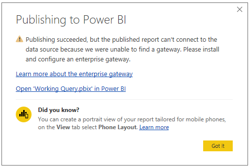

The report consist of two datasets, one with a custom visual and one normal bargraph. The data is a retrieved using Direct Querys
In power BI Desktop I get the following warning:

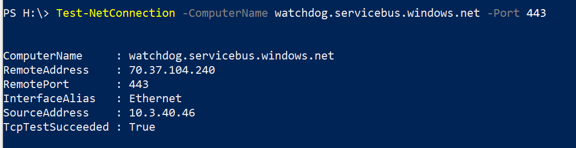

Testing the HTTPS connection to microsoft:
I can PM the loggs if someone want to have alook at them.

@FunDeckHermit,
Go to Settings->Manage Gateways, add SQL Server data source within gateway following the guide in the article.

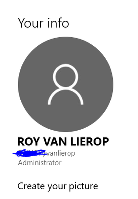

Everything is running on my user-account (local admin):
The network might be restricted, is port 443 the only port needed?
I am running in HTTPS-mode.
